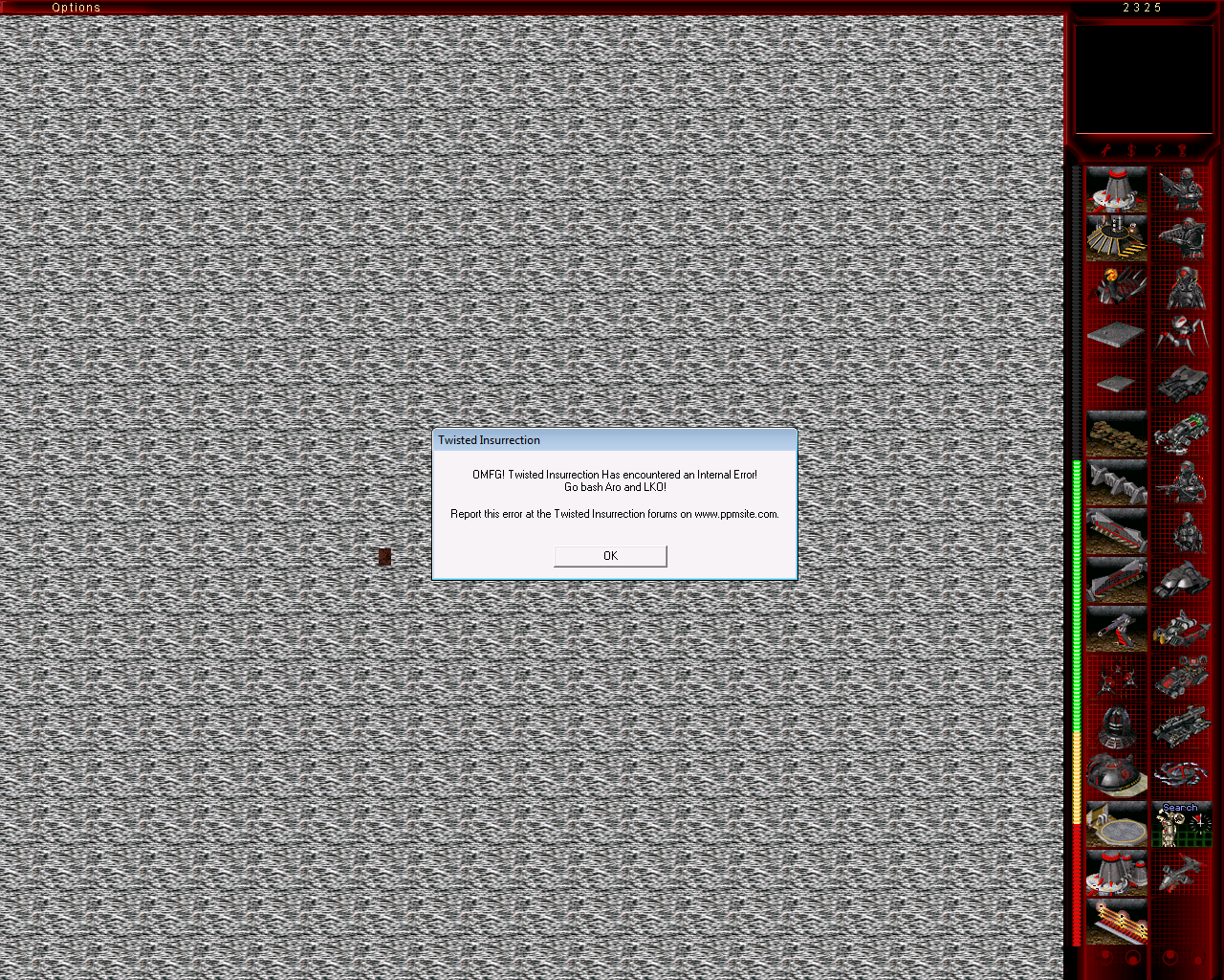

Error when playing the map Zeta City. It happened right at the moment the first Ion Storm starts, it must be related to that because I've been playing around for a while now without problems, but this was the first Ion Storm.
I don't have Win98 compatibility mode set.

Zeta City has been a problem before for random IE's, but I thought that had been resolved for the Public Release, it looks like unfortunately, I was wrong. I'm still not sure what causes that IE, but it's nothing to do with the Ion Storm because sometimes the map plays perfectly, and at other times, it IE's at any given moment. I'll look deeper into the map.
From the description, the jumpjet-ionstorm crash might've caused this one.

Every time I have gotten the JumpJet IonStorm error, I see a C++ Errors message rather than an Internal Error.

For me (and others) it has varied; sometimes I've got an IE, sometimes a Visual C++ Runtime Library error.

The other faction was GDI and had waves of Jumpjets, if it may help.

Then it's even more likely that the cause is a known engine bug (hard to fix) which causes the game to crash sometimes when jumpjets die on air when an ion storm starts.

Yeah, now I'd give it a 99.9% chance of it being Jumping Ions error. I wish I could pin-point this little pest.
